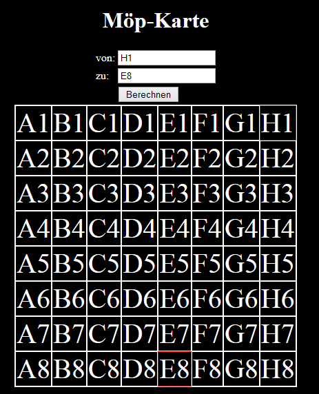

socressor Geschrieben 7. Mai 2014 Autor Geschrieben 7. Mai 2014 (bearbeitet) Danke abermals, aber ich meine programmatisch (PHP) Mein derzeitiger Stand: <html> <head> <title>Möp-Karte</title> <style type="text/css"> body { background: #000; color: #fff; } </style> </head> <body> <div align="center"> <h1>Möp-Karte</h1> <?php class map { function calc($from, $to) { $numeric=array($from => '', $to => ''); $letters=array($from => '', $to => ''); $splitter = str_split($from); $splitter2 = str_split($to); foreach($splitter as $fv){ if(is_numeric($fv)) { $numeric[$from]=$numeric[$from].$fv; }else{ $letters[$from]=$letters[$from].$fv; } } foreach($splitter2 as $tv){ if(is_numeric($tv)) { $numeric[$to]=$numeric[$to].$tv; }else{ $letters[$to]=$letters[$to].$tv; } } // var_dump($numeric); // var_dump($letters); //$this->view($numeric,$letters); //$this->view($from,$to); return array($numeric, $letters); } function x_axis($m=null, $n=null) { $data = array( "1" => "", "2" => "", "3" => "", "4" => "", "5" => "", "6" => "", "7" => "", "8" => "" ); if($m != null && $n != null) { $all = $this->calc($m, $n); //var_dump($all); foreach($all[0] as $signed) { if(stristr($m,$signed)) { $data[$signed] = $m; } if(stristr($n,$signed)) { $data[$signed] = $n; } } } return $data; } function y_axis($m=null, $n=null) { $data = array( "A" => "", "B" => "", "C" => "", "D" => "", "E" => "", "F" => "", "G" => "", "H" => "" ); if($m != null && $n != null) { $all = $this->calc($m, $n); //var_dump($all); foreach($all[1] as $signed) { if(stristr($m,$signed)) { $data[$signed] = $m; } if(stristr($n,$signed)) { $data[$signed] = $n; } } } return $data; } function view($from=null, $to=null) { $datax = $this->x_axis($from, $to); $datay = $this->y_axis($from, $to); //var_dump($datax); echo "<table style='border: 1px solid #fff; font-size: 40px; margin: 0 auto;' cellspacing='0'>"; foreach($datax as $keyx => $x) { echo "<tr style='border: 1px solid #fff;'>"; $datax[$keyx]=""; foreach($datay as $keyy => $y) { if($y == $keyy.$keyx) { echo "<td style='border: 1px solid red;'>".$keyy.$keyx."</td>"; } else { echo "<td style='border: 1px solid #fff;'>".$keyy.$keyx."</td>"; } } echo "</tr>"; } echo "</table>"; } } $mapClass = new map; ?> <table> <form method="POST" action=""> <tr><td>von:</td><td><input type="text" name="from" placeholder="From"></td></tr> <tr><td>zu:</td><td><input type="text" name="to" placeholder="To"></td></tr> <tr><td></td><td><input type="submit" value="Berechnen" name="calc"></td></tr> </form> </table> <?php if(isset($_POST['calc'])) { $mapClass->view($_POST['from'], $_POST['to']); }else{ $mapClass->view(); } ?> </div> </body> </html> [/PHP] Das sieht so aus und makiert derzeit Start und Ziel. Bearbeitet 7. Mai 2014 von socressor Neuster Stand

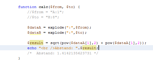

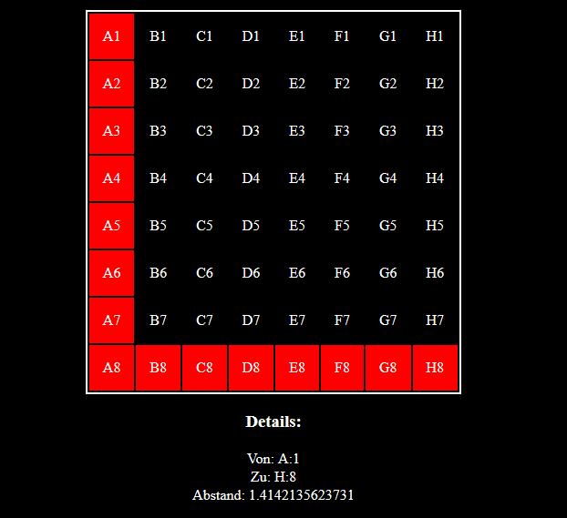

socressor Geschrieben 7. Mai 2014 Autor Geschrieben 7. Mai 2014 (bearbeitet) Habe etwas probiert, aber vermute das es nicht richtig ist: Das sieht dann grafisch so aus: Bearbeitet 7. Mai 2014 von socressor
Klotzkopp Geschrieben 7. Mai 2014 Geschrieben 7. Mai 2014 Mach nicht gleich alle Berechnungen in einem Ausdruck. Berechne erst einmal den horizontalen und vertikalen Abstand. $dataA[1] ist keines von beiden.
